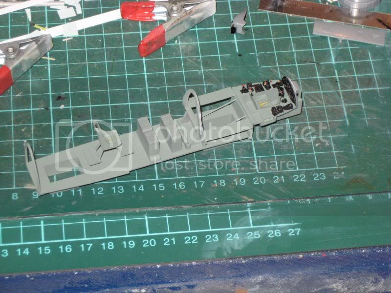

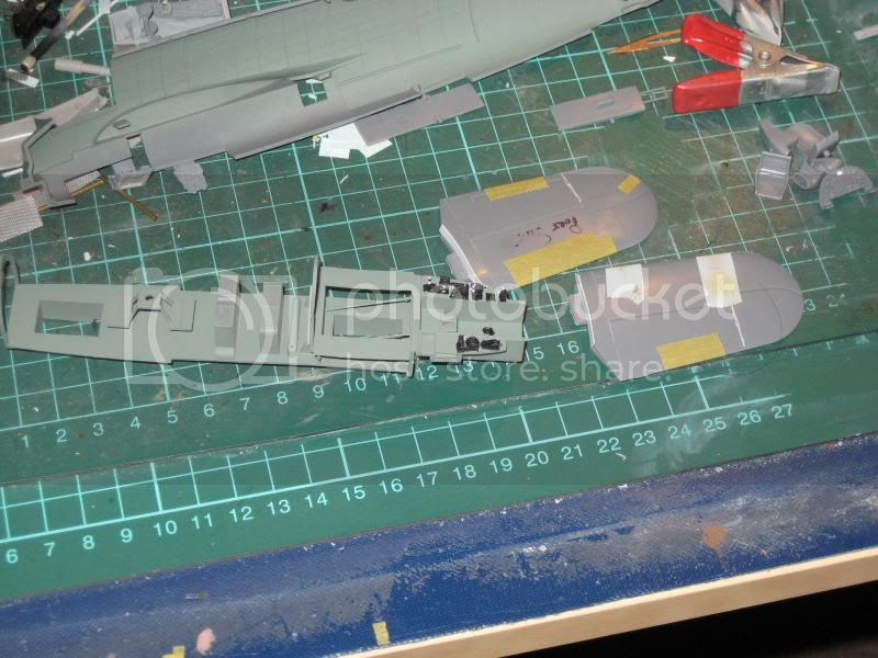

Kit tail plane assemblies, with Evergreen strip fillet.
40mm weapons made from Evergreen tube. Other added or altered kit parts also shown.

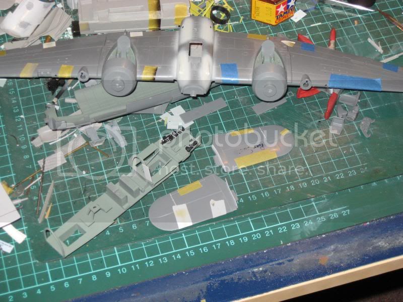

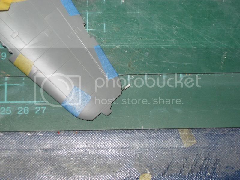

A little more progress on this build.
Addition of the Port wing formation light. Dry fitted to wing assembly.

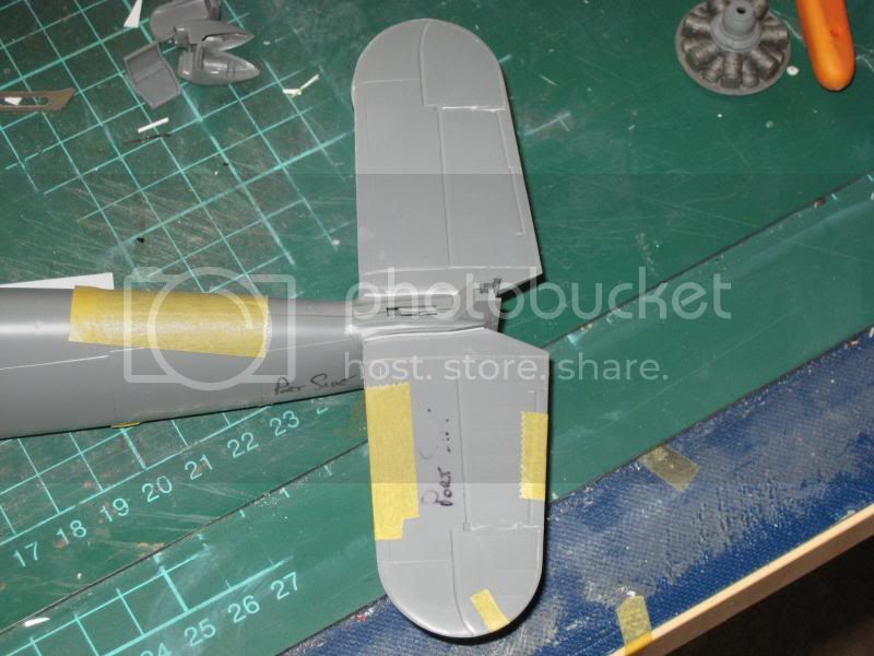

Dry fitting of Horizontal tail plane sections.

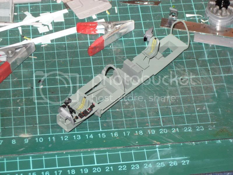

Two views of the kit fuselage floor plate.
Note: The Evergreen strip covering the gunsight mounting in the instrument panel. Kit decals used for the crew harness's.
