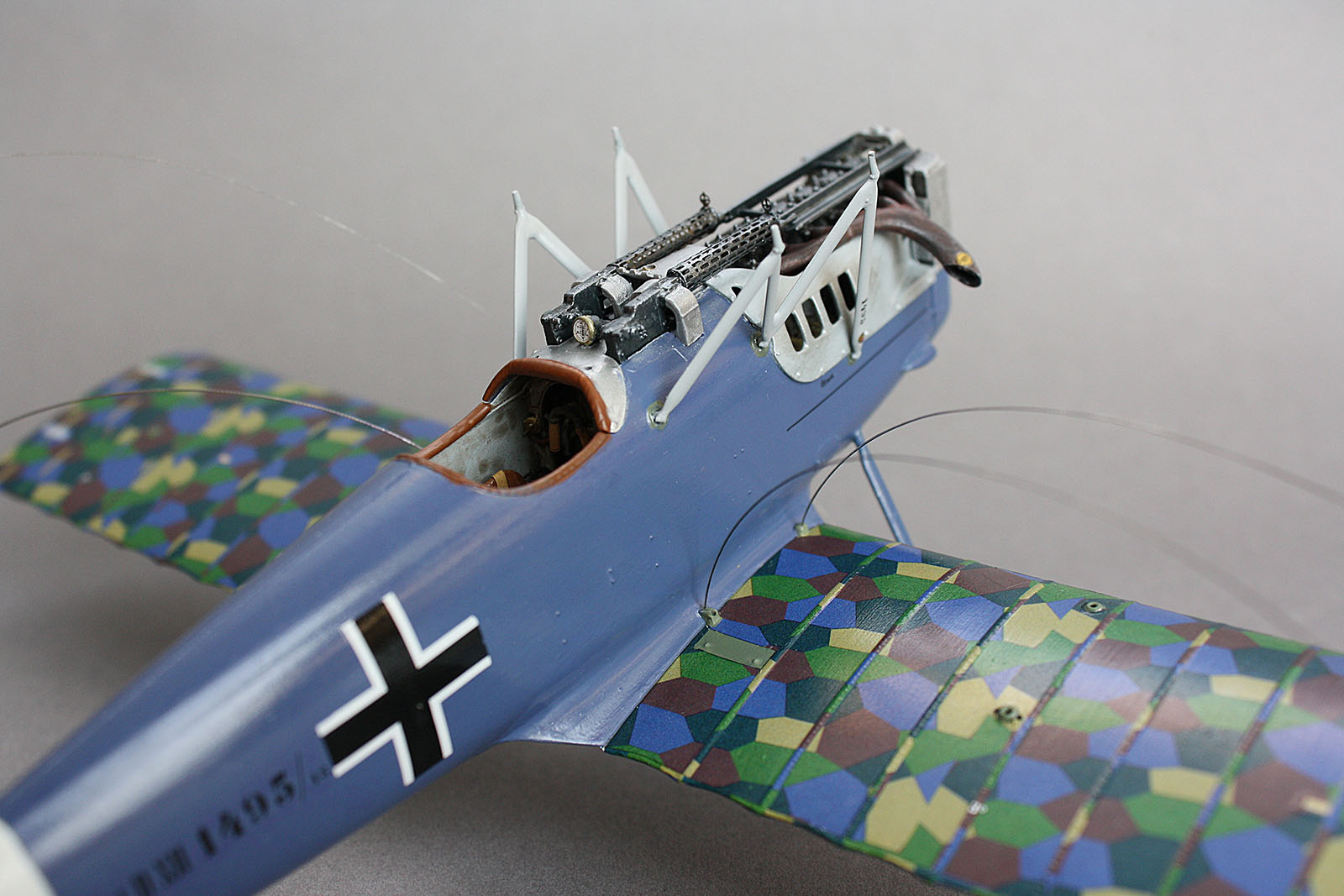

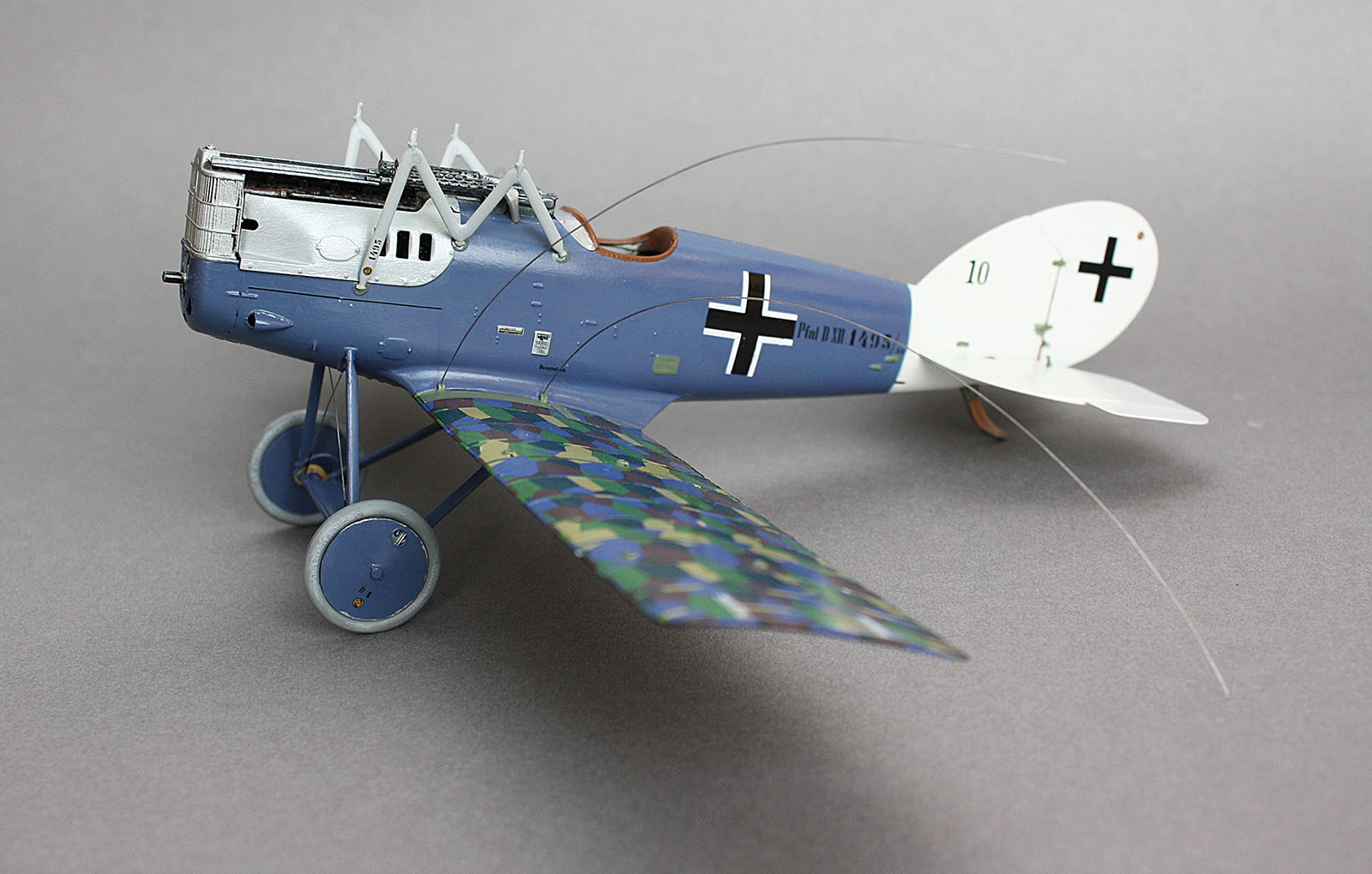

Fuselage halves around the interior and engine. Rudder is installed, but otherwise the fuselage is void of details.
The woodgrain was painted as if I were doing clear varnished plane, though I did go more noticeable on streaks and coloration. Semi-transparent black glazing was applied until wood is almost all but covered - wood shows through with strong light and/or at certain angles.
Engine offers nice contrast to the wood - making an Albatros in maintenance mode (cowling off) a sure probability for near future.
Engine receives a fair amount of oil wash to simulate grime - this is pre-mixed wash that's been sitting around in a jar for weeks, so the resulting mix dries like crud and heavy soot.
The overall joy of building Early Aviation aircraft is demonstrated here - jumble of steel and aluminum, next to bare brass, both varnished and glazed wood, leather and even a touch of silk-screened fabric...
